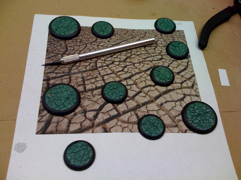

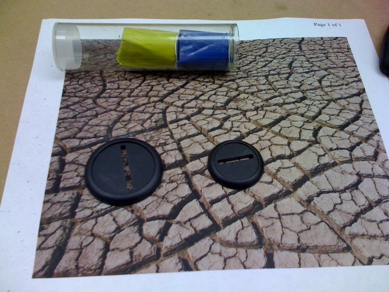

    Step 1: Find a picture of cracked earth as a refrence. Get some Green Stuff(the amount in the pic is WAY more than what is nessecary) and your bases.

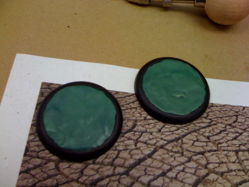

    Step 2: Take a small ball of Green Stuff and smear it out into the recessed region of your bases. You don't need alot for this and you only want to bring the base up to even with the edge. Once you have the GS smeared even, wet your finger tips and run it over the Green stuff to get rid of your finger prints.
    Step 3: Allow the green stuff to cure for about 10-15 minutes. Then grab your handy dandy sculpting tool, I used an exacto blade. Wet the tool and then while refrencing the picture do your best to mimic the effect. I found small triangles worked the best. When you draw the lines make a few lines thicker, a few thinner.
